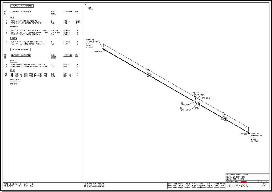

Found the error and solution:
error is because in PDMS default nozzles for DN15 to DN40 bolt dia of BTSE are mentioned as M12. but i created flanges with btse of bolt dia M14. solution is to create new own nozzle spec with matching to created flange btse.
