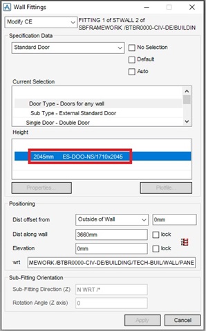

    Hi Guys
    How can i modify the door, i see that every door has width 1710 , i want 4200mm ,
    wut should i do?
    Tanx in advance

    It would be a gate not a door .... How about design parameters?

    i created fitting(door) in the wall, but when i was selecting the items for door i saw just 1710mm width, i need more.
    wut should i do?

    You may produce your own SFIT with other prameters:
    this door has Param 1700 2045 806 1994 40 95
    and name is /ES-DOO-NS/1710x2045
    In PARAGON make new SFIT (as you did catalog of piping elements) with other parameters.

    This old thread is related to my question....Would like to create a new door with a different width and length..is PARAGON the only option?
    We are using E3D 2.10...This is only door on our form...

    Yes must be set thru paragon ONLY.. unless you initially create it using editable Template Design.. then it will be other option.
