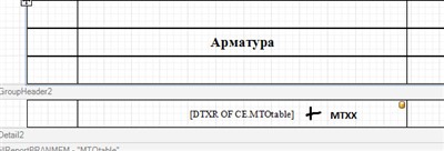

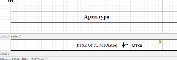

    I founded-calculated field should  be used with expression like :
    ([DTXR OF CE] + [DTXS OF CE])

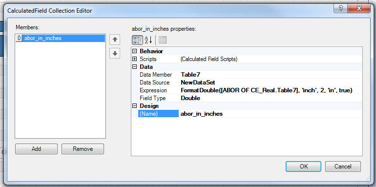

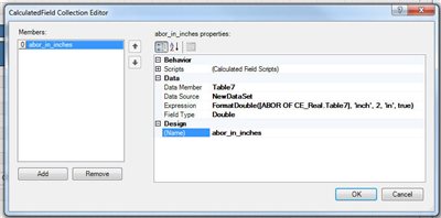

    has anybody figured out how to change abor from mm to inches in report designer?  i have tried using a calculated field AND tried using the FormatDouble([ABOR], 'inch' ,2, 'in', true) function with no success!!

    Why dont U switch Units in Settings>Units Or problem is more complicated  ?

    yes, more complicated.   the project is in mm, but i want the output for report in inches.  in quick reports, you can set the units to finch, but i can't figure out how to do it in RD.  i've been working on it for a whole day!

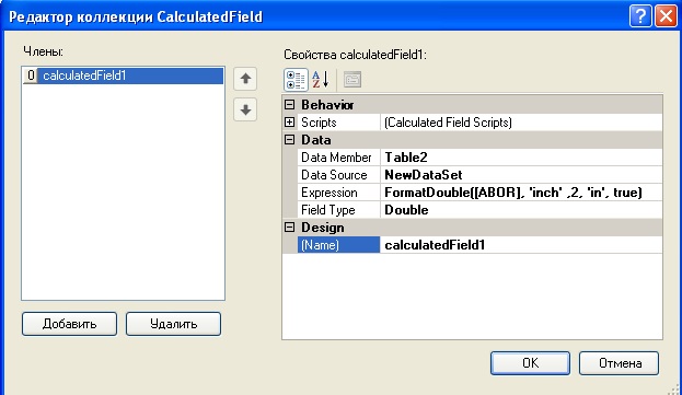

  • me_hungry
    me_hungry over 11 years ago
    I tried your syntax, it works fine.
  • me_hungry
  • marisa deleon
    marisa deleon over 11 years ago
    i must be putting my function in the wrong place!!  where did you put it?  in the calculated field in the "edit" expression?

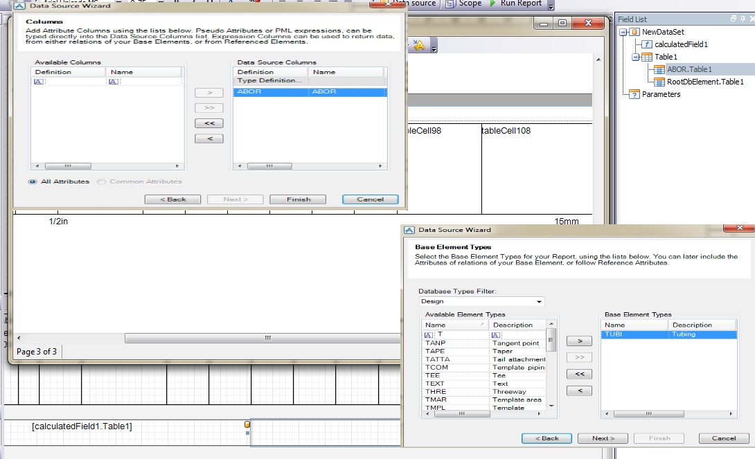

  • marisa deleon
  • me_hungry
