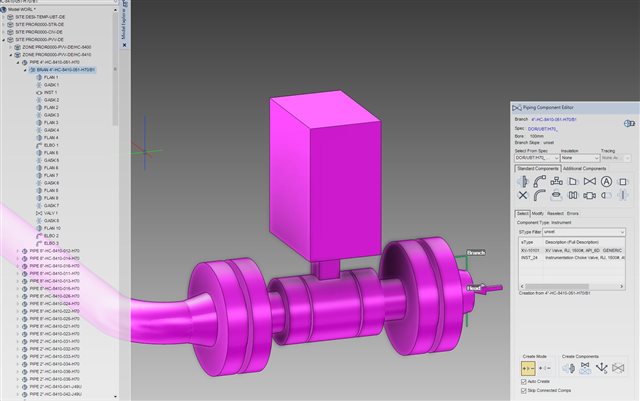

    I added a component (a control valve) to PARAGON and it shows after a GETWORK in my MODEL session.

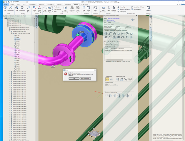

    But on a designer's system it doesn't appear in the GRAPHICS VIEW or on the PIPING COMPONENT EDITOR form.
    We tried to add the VALVE by changing a FLANGE's SPREF directly via the COMMAND WINDOW.
    It is still ''UNDEFINED'' in the designer's MODEL SESSION.
    After several GETWORKS and a restarting MODEL it still doesn't show in the designer's GRAPHICS VIEW.
    Please see the differences between the SESSIONS below:
    Could this be due to a low network latency?
    Our MDB's are the same for PARAGON and MODEL.
    We are using E3D 2.1.0.27....any suggestions?
    Thanks for your Time!

  • Hi Sylwia,
    Thanks for your reply.
    It turns out a that they are two different projects! Another admin created a study project and the DB were not in the study project MDB!
