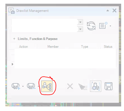

You must click that button and you get the Collection Form.
In there you can define three kinds of Collections: System, Shared and My Collections
That's it !

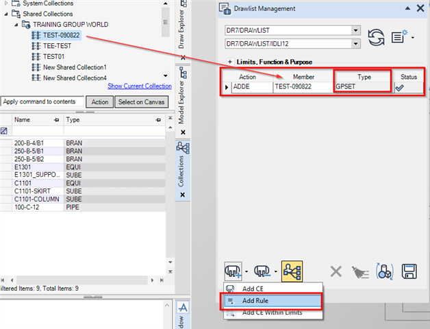

we find the solution. if we drag the required collections into the drawlist manager, the objects in the collections are added into drawlist. thanks
Good! Thanks for the feedback
Yes you are right. And you can use Add Rule button. Next, manually enter the collection name in the Member field and the element type GPSET.
