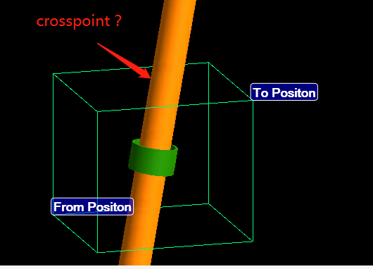

Hi Experts, If a pipe passes through a volume, is there any way to get the pos of the intersection of the volume and the pipe, I'm doing this to add a pair of flanges at the location of this intersection.

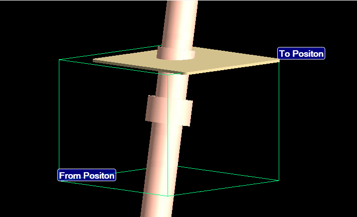

Thank you Galluzzi, Do you mean like this, create a virtual PANE in BOX TOP, then select this PANE and BRAN, then create the parts
You can define a splitting plane in the Split Pipe Form directly
NEW FLANGE CHOO ALL CONN POS PA DIST 1000 FROM PL OF PREV
This is the command I found from the forum to add the flange, please ask how can I use the command to add flange in the PANE and PIPE focus POS?
