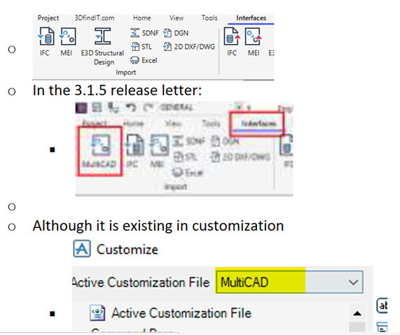

Hello there,
Why is MultiCad button missing? does it have separate installation?
Hello there,
It is included. No separate installation.
Uninstall and re-install E3D from scratch
Corrado Galluzzi thanks, it works after uninstalling and re-installing E3D from scratch.

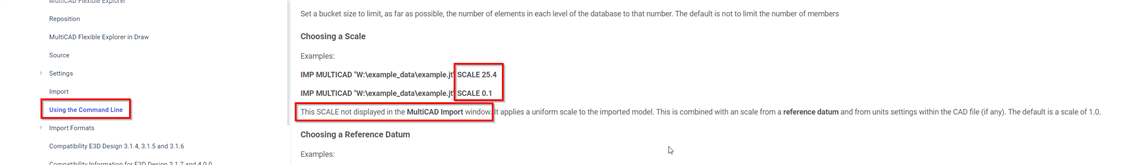

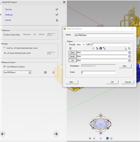

hi Guys,
do you know if it is possible to modify the scale of 3d in multicad
in the reference datum, i can change the scale with whole numbers but not decimal.
do you know if it possible to do a scale with decimal,
example 0.01, 25.4
thank you for your feedback
regards,
Axel
thank you,
it works great
