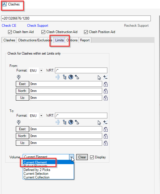

But just to give you a small example, take a look at the attached picture.
Through Areas you could define volume-wise the scope of your clash check:
