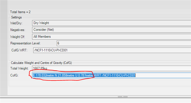

COG report gives value from E3D 0,0,0 but i want to calculate for a module so what i want is to take COG value from required modules one end. can we do that?
I am not sure I have understood but....
You can create a DATU element and position it where you need.
Then you can calculate CofG with respect to it.
At ZONE level, on the Command Window you could type:
NEW DATU /MODULE-ORIGIN
HEIGH 1000
POS EXXX NYYY UZZZ
Where xxx, yyy, zzz are the required coordinates.
Or you could also reposition it using move command
yes, you understood right.
Thanks that works
