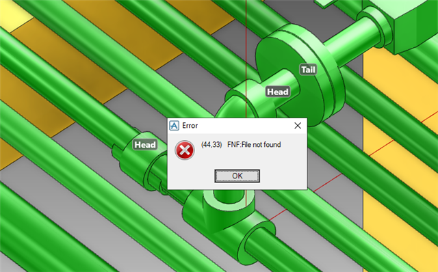

Dear Experts,
i tried to extract the isometric but it's showing error.
i have attached the error snap also and FNF error
kindly advice.
THANKS & REGARDS,
THIRA
Dear Experts,
kindly advice.
THANKS & REGARDS,
THIRA
Check the iso option file. It should be called previewisostd,txt
sir,
could you please explain step by step
Enter ISODRAFT Module
Check and eventually modify the option file called previewisostd.txt
Maybe you have some wrong path/filename in there
If this is not clear, then I suggest to contact your E3D Administrator.
If the Company E3D Administrator is you....then I suggest you to attend a specific Isodraft Administration Training Course
Thank you sir
I am designer so i will contact my admin
