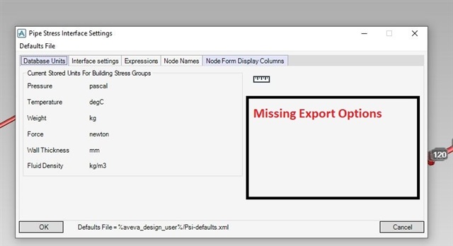

Hello /*,
Are the export template options available in E3D 3.1.4? We can't find them in the "Interface Settings Tab"
Any suggestions?
Thanks for your TIME!

What do you mean with "export template options"?
The form you have attached is the correct one....

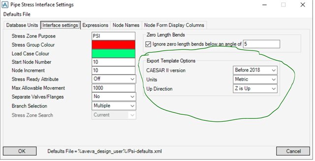

This is mine from E3D 3.1.6.1
Hi Corrado,
The ones in the interface settings tab.
They seem to be unavailable in 3.1.4....all our 3.1.6 installations have this option.
Is there a way to activate them in E3D 3.1.4?
Ahhh ok! Thank you for the new image. The previous one showed the wrong tab....
Yes, Those are new options that have been introduced recently.
I mean, the User interface has been enhanced in order to manage what was already possible by
editing ...Everything3D3.1\asso_products\psi\core\convert_to_cii.bat file
