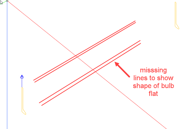

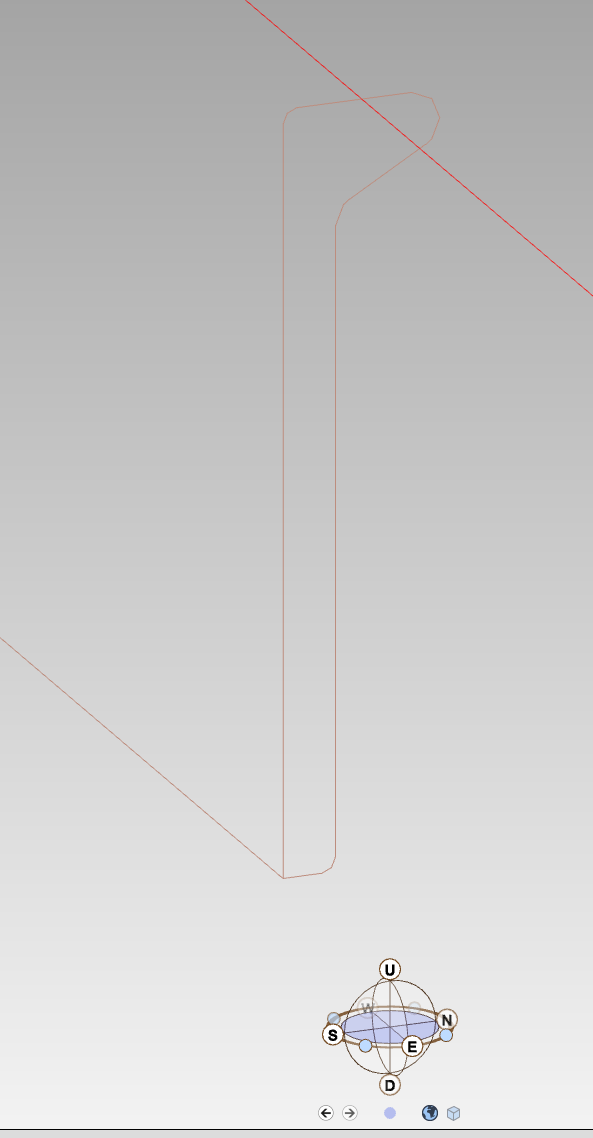

Has anyone else had issues with the display of bulb flat steel sections when using wireline ?
They disappear when I go to wireframe which makes it extremely difficult to work with
Any help appreciated

can you post a snap of issue

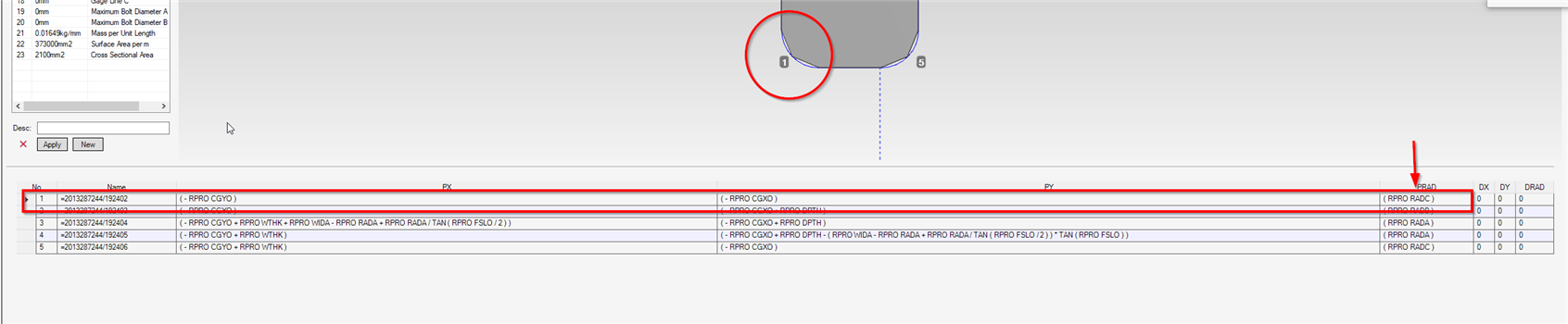

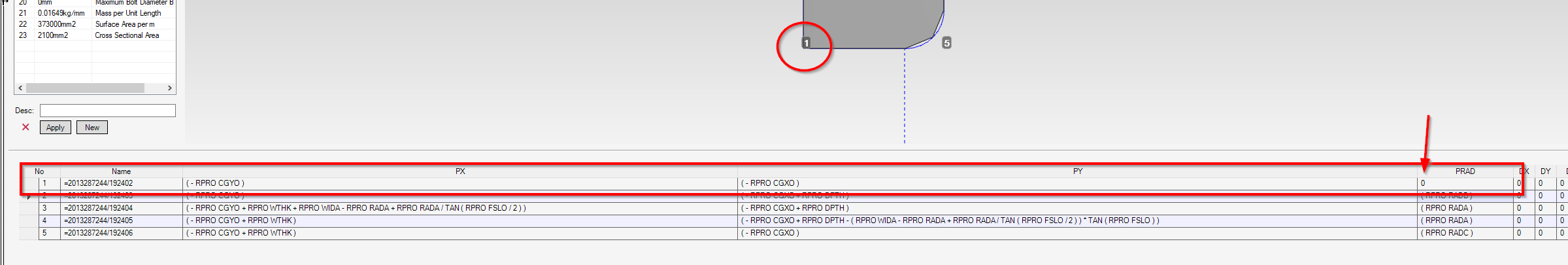

It seems there is an issue when setting a fillet radius (PRAD) to the profile vertexes in Paragon (SPVE of SPRO).
I would suggest you to open a Case on Aveva GCS Website.
See images here below
With a positive PRAD:
With PRAD set to ZERO:

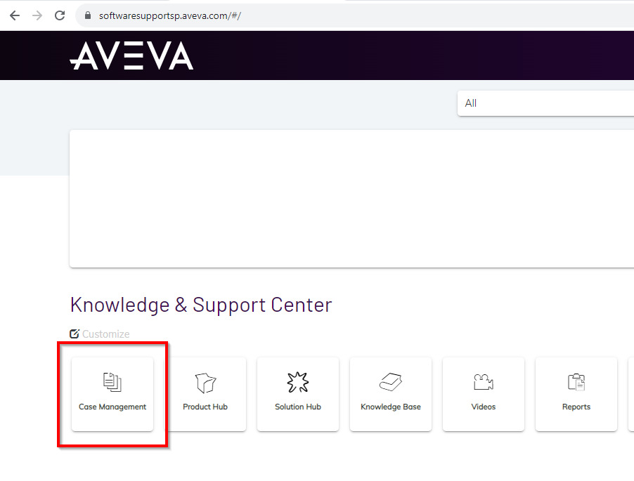

THanks for that. Where do I do that ?
Do you have a link pls
Try with https://softwaresupportsp.aveva.com/#/
You must register...
Seems I can't submit this issue as the case management button is greyed out. I guess I have to live with it
Check with your Company if you can get access to the Case Management button
Thanks for that
