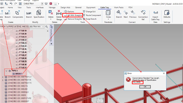

Hello Everyone,
Any idea what's missing in my cable tray spec to be giving the error below?

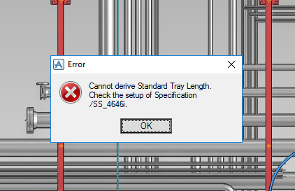

Hello Everyone,
It works on a previous project where i exported the spec from but not working on this project.

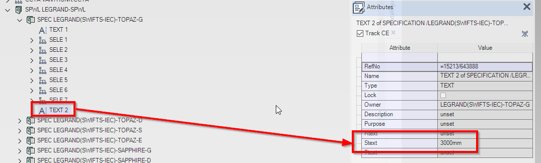

Make sure your Cable Tray Spec contains a TEXT element where STEX attribute value is set to the standard straight length
