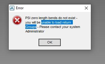

Hello /*,
This message appears when we try to start the PSI in a project.
Is a 'Return Group' an Element for storing the lines imported from Caesar back into E3D?
Thanks for your TIME!

Yes, it is the Stress Group that returns from Caesar II.
You create a Stress Group in E3D.
You export it to Caesar II
You (eventually) read it back in E3D
