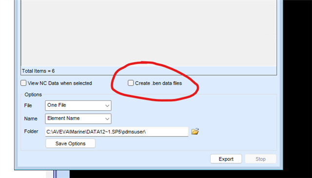

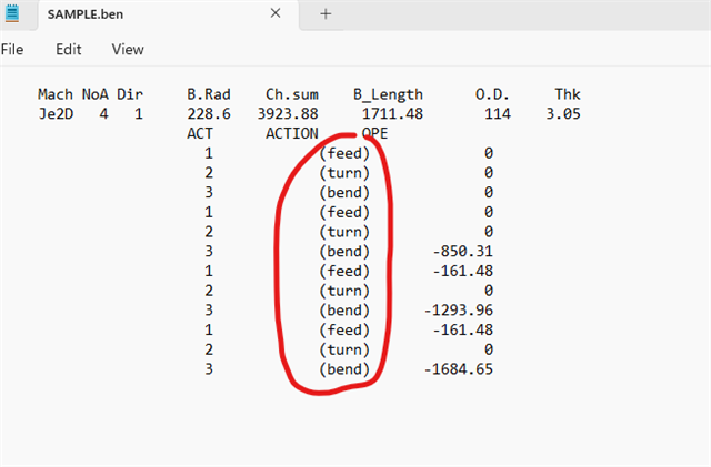

I’m using Fabrication NC data to export bend data information (*.ben) from design module.
So how can I modify or customize the template such as : change (feed) to (X)...or something like that

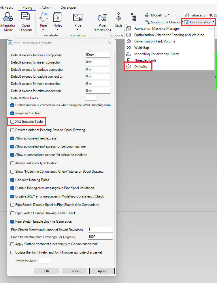

Try checking this option:

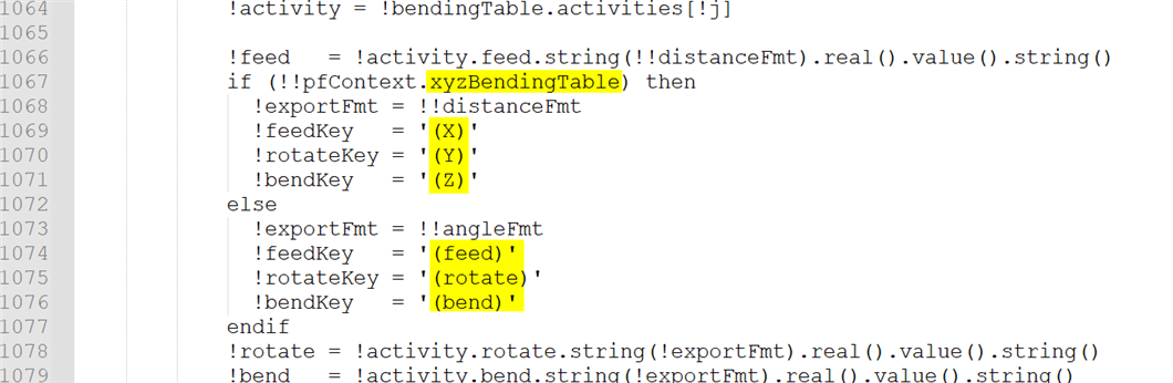

Or you can try editing pfFabricationNCData.pmlfrm file with a text editor.
You can read docs.aveva.com/.../994550.html
Very clear. Many thanks Corrado Galluzzi
