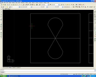

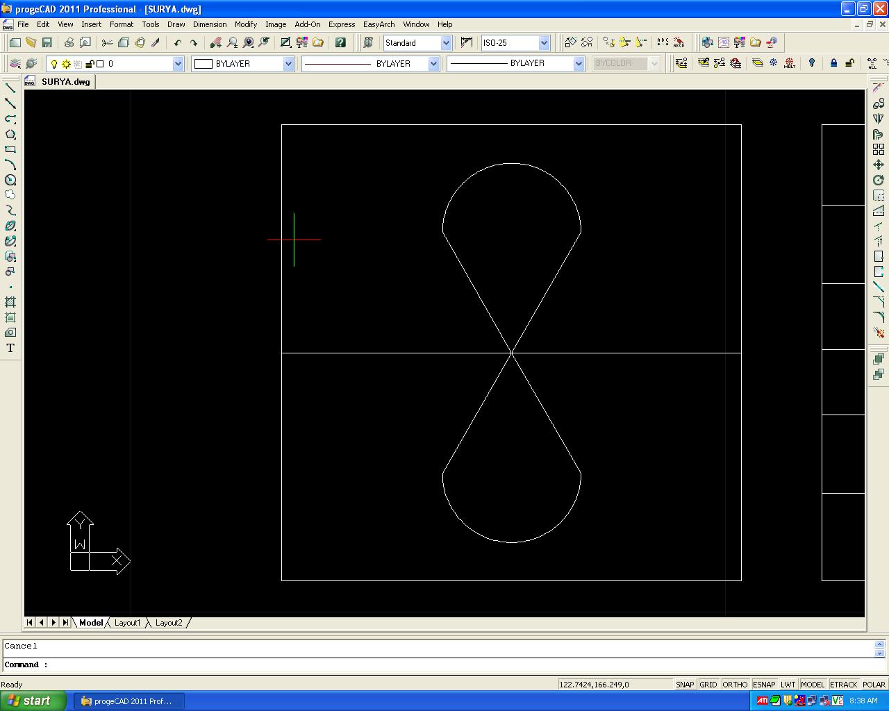

ohh my god its very difficulty sir,i was thinking after posting here that we cant use spline?i have tried by using list command but i got only 2 stra.mrkp.
its a turbulent flow controller having one rectangular box at centre eight symbol will come.now am thinking how to make that eight,now i dnt have dat symbol i can post u tomaro from office
