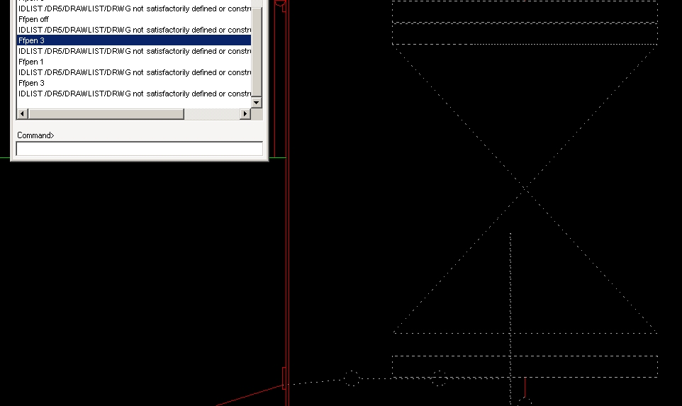

Tried everything...and the result is always the same.

I don't have that...but then I'm only using 11.6...is it version 12 ?
Sergey...
no result... My centerline is still chained, now with style atts:

In your previous post with pics I saw exactly what I need - your centerline becomes dashed under panel...Now I'm really confused :((( I saw that is possible. May be this is very bad difference between 11.6 and 12??? No idea...
