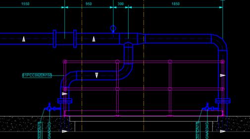

I am having below two problems with the macro. please advise.
2. Arrow does not aligned with pipe in actual flow direction.[ATTACH=CONFIG]10531[/ATTACH]
Thanks in advance
Check your symbol orientation in library. (right/left/up/down)
you must set either one to suit to the macro.. and place MRKP point so you know the placing mark point.
