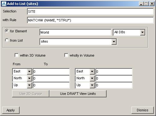

  • h hyhy
    h hyhy over 12 years ago
    Is it possible, instead of add all sites, to add only sites with structural components.
    In my current project we've got a over a hundred sites, but i want to filter STRU sites only in drawlist.
    (SITE: P-200-STRU, P210-STRU, P220-STRU etc.. ?)
    thanks already

  • h hyhy
    Hi,
    I've tried this but get error message:
    ' (46,28) ERROR - Variable FROM not defined'
    Any idea
    thanks
    Rene
