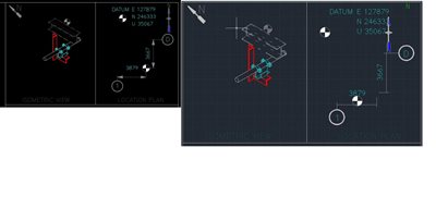

    i did it, but some variation is there in fonts,please have a look on attached file,what is the problem and how to resolve it?
    anybody there to help me on this?

    Did U copy font from pdms to acad?
    d:\AVEVA\Plant\PDMS12.0.SP6\AutoDraftFonts\

    yes i copied pdms font to autocad font,its not font problem, the datum is chaning its location
