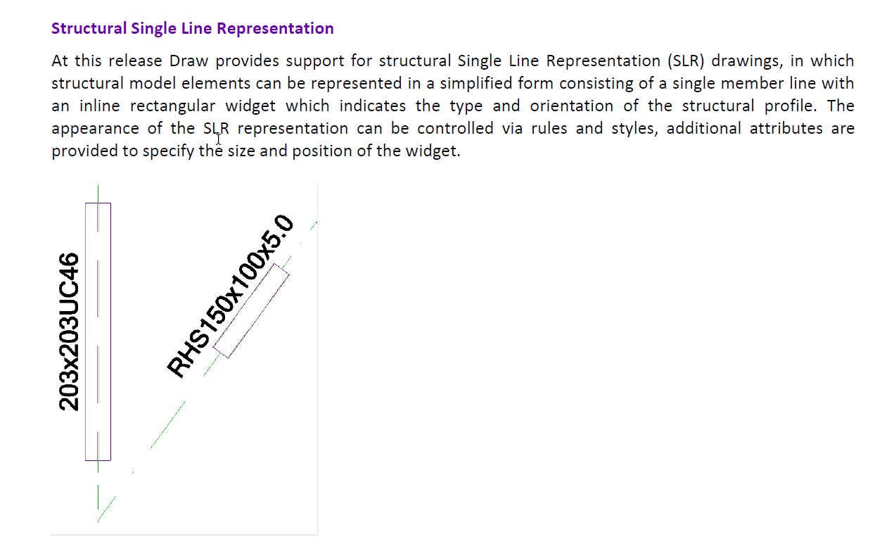

    Corrado Galluzzi over 1 year ago in reply to Sri
    By the way.....this comes from Aveva Unified Engineering ( E3D 4.0.0.0 ) Release Letter:
