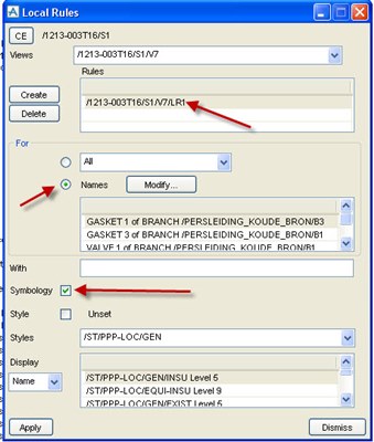

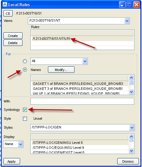

    You can remove piping components from the Draft view via a local rule.
    Create a local rule and select 'all' and then in the 'with' input type something like 'type eq VALV'
    Then turn the omitted flag to true - a RRUL property.. All VALV will be removed from the view...
    Slightly different to above but means you don't need to add to the drawlist
  • Juan Manuel Gutierrez Valderrama
    Juan Manuel Gutierrez Valderrama over 12 years ago
    Try this
    http://www.avevaworldusergroup.com/forum/showthread.php?t=13272
    I use this method also for hide pipes or parts, but you can't hide only a component.
