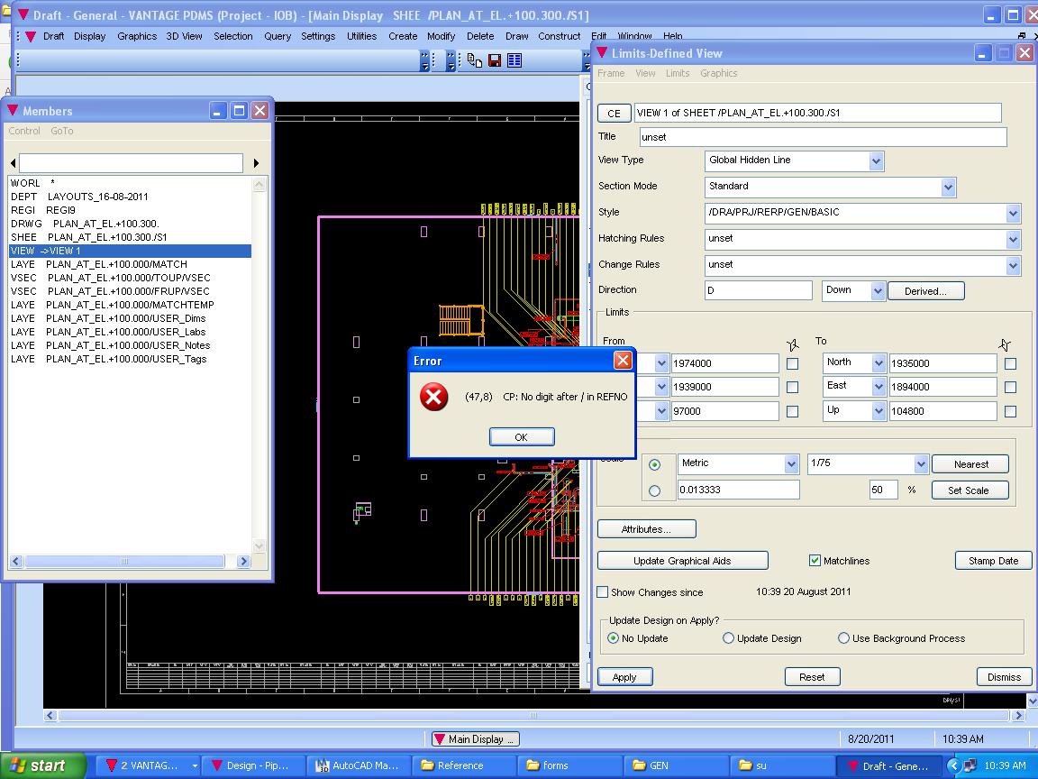

No digit after / in reference number

=16387/24959/FREP/VSEC
Does this element exist?
Amit
over 4 years ago
I am facing same issue.
element does not exist.
Raymond Metselaar
over 4 years ago
That means that the section plane is deleted, you will need to make the section plane again or copy it from another drawing.
