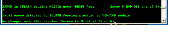

Throwing out from draft while updating it.

We get this sometimes, datal the drawing, delete it and run the datal back in, only solution we found that works.
