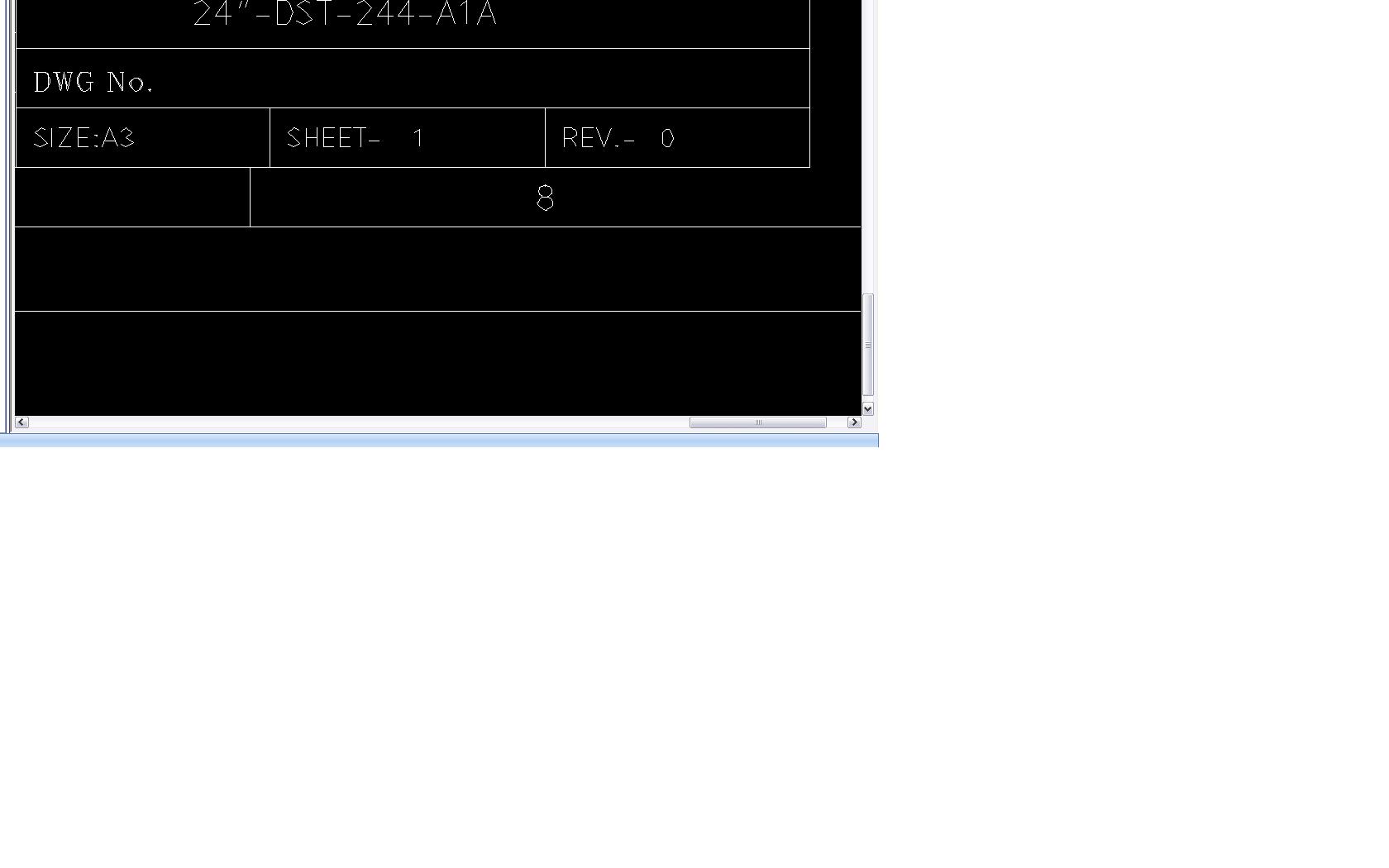

    [QUOTE=sherly;67520]Dear all,
    In my isometric drawings sheet nos are comming like ,sheet-1,sheet -2,sheet-3.But insted of this i need Sheet-1OF 2,SHEET 1 OF 3 ... like that.Iam already edited the options files and backing sheet.In backing sheet i given this command for btext-Btext #SHEE(P/2:)(C3:).But also no effect.Please give a solution for this case....its very urgent...please consider my case as serious.......
    Hi Sherly,
    You need to post this thread on isodraft module area.
    Goto your option files and standards frame texts>>>change sheet no and sheet total..
  • Sri
    Sri over 11 years ago
    [QUOTE=me_hungry;79454]I am also have problem with sheet numbering. Something worng with name asign.
    [ATTACH=CONFIG]6763[/ATTACH]
    What is wrong with option file?
    Hahaha PDMS Doesnt allow duplicates  but its produces..... ?
