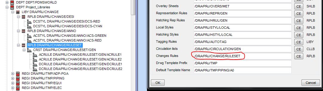

When i log on on draft module. it's one error appear:
But i can continue on draft. and some error when i click display--> appware load error I see in below picture
When i create department, this here error:
How to fix it? can some one help me?

http://www.pdmsworld.com/forum/entering-draft-madule-10256.html
Mandark
over 13 years ago
These are defaults for the draft u can assign them in settings->user defaults.
If you have admin rights set these values or ask your admin to set these defaults.
muthuvel
over 13 years ago
these are values are governing the draft sheet managemnt. so it has to be set up. please inform to your pdms admin.it's very easy to set up.
Venkata Rao Peta
over 13 years ago
$m/C:\AVEVA\Plant\PDMS12.0.SP6\PDMSUI\dra\data\master .dat
$m/C:\AVEVA\Plant\PDMS12.0.SP6\PDMSUI\dra\data\projec t.dat
In the above specified location you are having project.dat and master.dat
Check once
Nguyen Hong Anh
over 13 years ago
Thanks corrado, i followed as you said... many errors have repaired but still one error in below picture when i click display-->> appware load errors:
i checked and did again but this error still have... How to do it?
