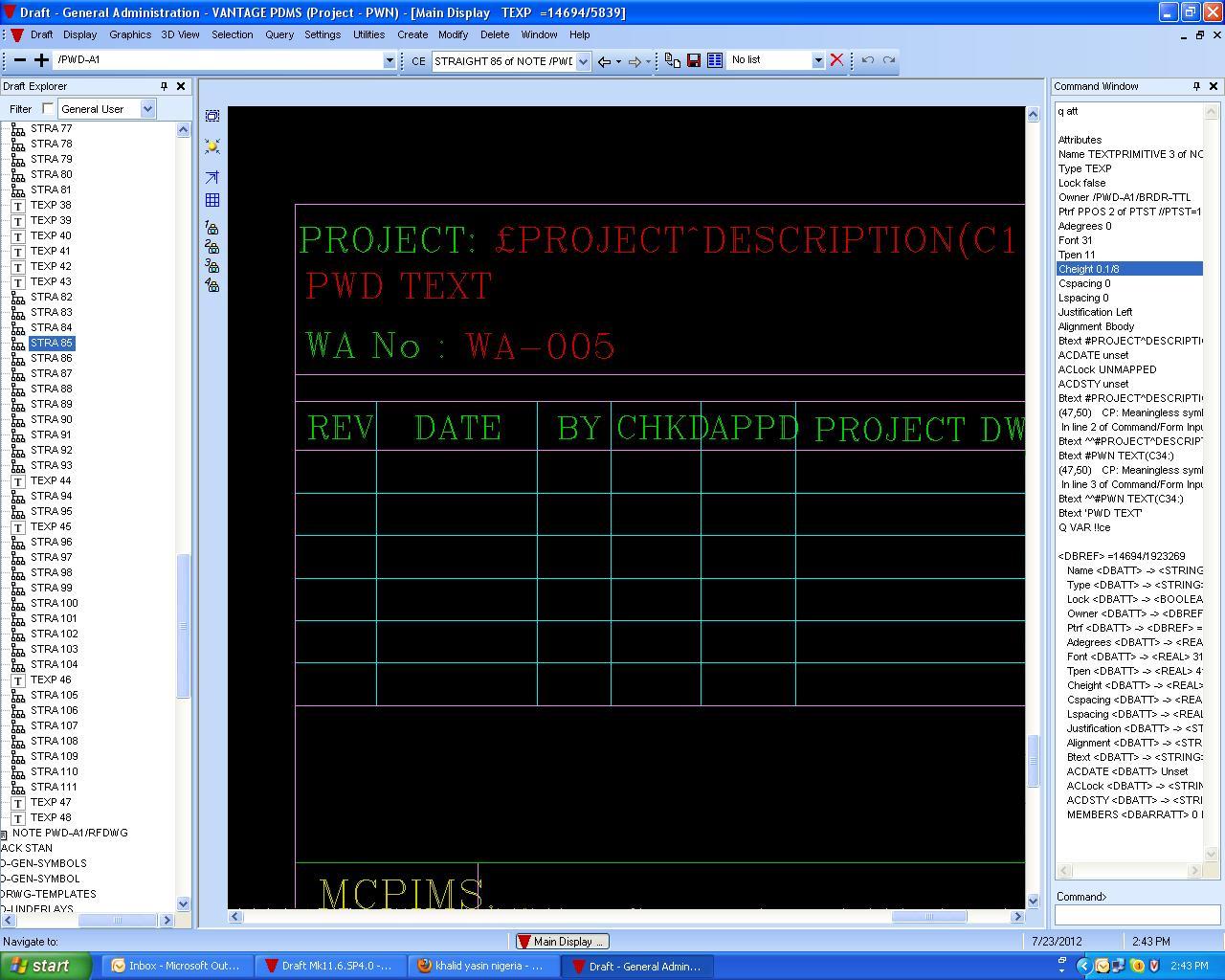

    One archaic method could be the one described in C:\AVEVA\Plant\PDMS12.0.SP6\Manuals\Docs\DRAFT User Guide.pdf Chapter 9.3 Drawing Revisions.
    And you can check the way the revision table is set at the bottom left corner of Aveva supplied Backing Sheets (i.e.  /DRA/MAS/BACKS/MET/A0 )
    Or you can  define and use U.D.A.s at SHEE level. It is probably easier.

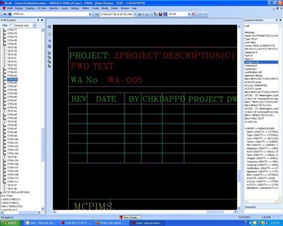

    GOT IT WORKING :D GRACIAS!! I used the 2D copy and Construct>Repeat>Rows and Columns.
    How do you define UDA's at sheet level?

    Lexicon module allows you define the UDA'S at sheet level...
