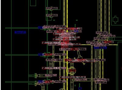

    Please write exactly for what you need to do labels....

    Have u checked the automatic label placement???? If not then try it out. I think it will solve your problem...
    Go to Modify---> Label ---> label placement
    select all the Labels
    then give the placement definition
    All the labels will be automatically placed as per your given definition..

    i actually used auto label placement but tags goes outside the view and when i edit
    it by using model editor my pc gets hang...

    I hate when they go out side the veiw!!!
    Run it once and them go out the, you should be able to see the leaders.
    The open the auto placement box again and remove all the lable then select i think its id labels ( NOT In pdsm to check)  and tou ch/pick the leader lines of the ones out view. Increase you maragen value and re-run . Now you will have two layers  and will  havet to tweak the hell of it but at less all your labels where you can get to them easy.

    there is no separate autotagging rules for different components.
    i think this will be a mess to do autotagging at a time, why can't you go for individual autotagging
