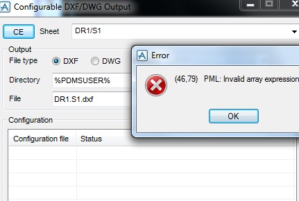

    This is the error it is placing in command promt
    [/U](46,79)   PML: Invalid array expression
    In line 43 of PML function findfilewild
     do !file values !dir.files()
    Called from line 93 of PML function uniquepath
       !full[!i] =  !!findFileWild( !path[!i] , !rootFile )
    Called from line 462 of PML function dxfuser.BUILDCONFIG
     !fileArray = !!uniquePath( 'dra-dxf-*.pmldat', 'USER PROJ PDMS', '' )
    Called from line 175 of PML function dxfuser.INITFIRST
     !this.buildConfig()
    Called from line 1 of Command/Form Callback Command
    !!dxfUser.initFirst()
  • ZAPPELLA
    ZAPPELLA over 12 years ago
    DELETE  "." in name of file  dr1.s1.dxf
  • Srikanta
    Srikanta over 12 years ago
    BREIZ,
    Still I have a same problem after deleting "." from the name. It does not even show configuration files for selection.
    Rgds
  • ZAPPELLA
    TRY to change youre directory...c:\temp  for exemple
  • Juan Manuel Gutierrez Valderrama
    Juan Manuel Gutierrez Valderrama over 12 years ago
    I've just checked with PDMS12.0 sp6 and it's OK, also if the name is with dots.
    Have you the problem with all the configurations?
  • Srikanta
    Hi Guys,
    Thanks for your reply, I will try and let you know the result.
    Rgds
