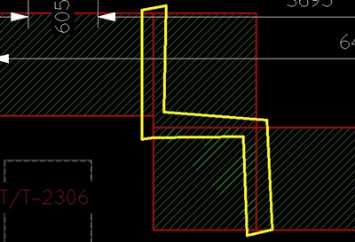

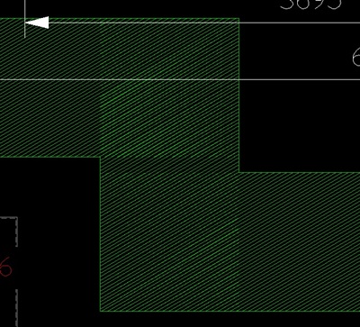

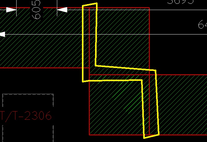

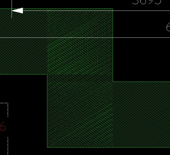

    how is that access way made? I mean with primtives?
  • NAGENDRA VUDDAGIRI
    NAGENDRA VUDDAGIRI over 12 years ago
    If it was done with separate boxes, try to make it will single extru
  • Srikanta
    Srikanta over 12 years ago
    You need to set DUNION attribute in Design.
    From the Main Menu Bar (Beams&Columns or Panel&Plates application): Modify-->Draft Edge Drawing...
