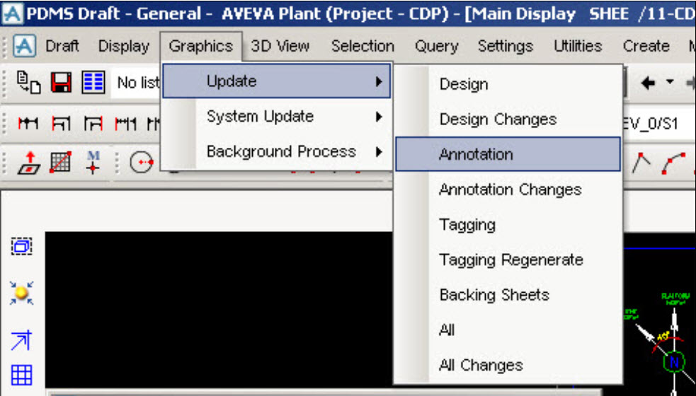

Updating design/drawings in DRAFT Module

Update Design - UPDATE DESIGN
Update Annotation - UPDATE ANNO
Update Tagging - UPDATE TAGG
Update backing sheets - UPDATE BSHEETS
Update all - UPDATE ALL
And additional
UPDATE PICTURE - use to update picture files (if corrupted)
UPDATE PENSTYLES - to update all user styles
and another trick type UPDATE $H and you will see all available parameters
