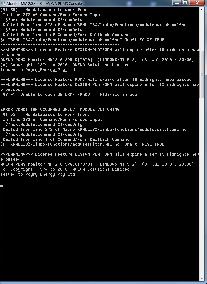

If you can post an image from your Monitor Console Window (the black dos-like form), we can read the error message in detail and maybe understand the reason why.

I will as soon as it happens again.
