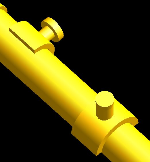

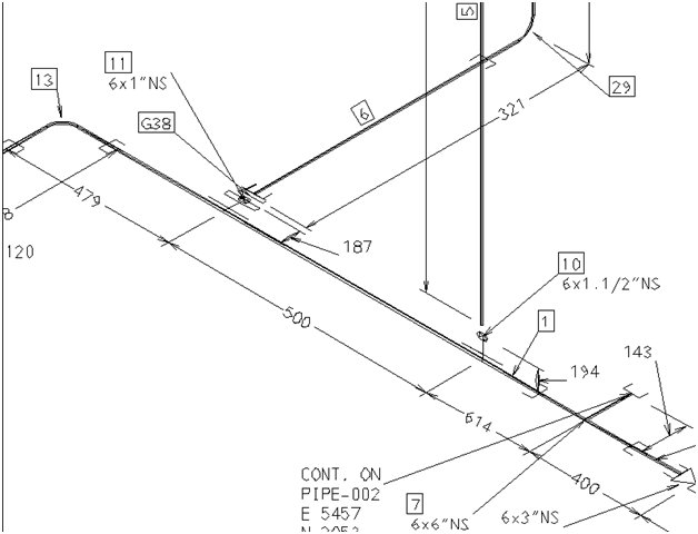

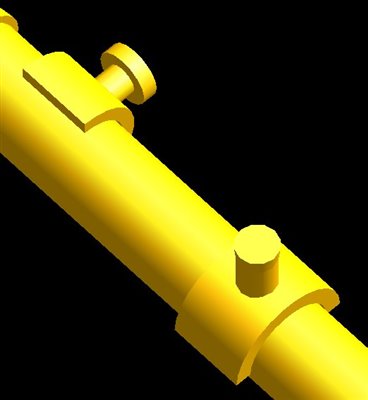

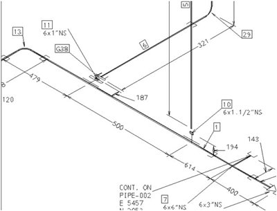

    I got the weld mark off now, and the next is the line from arrive to the saddle.  Is there a way to get the line off?
    thanks for your clues.
    nerdy..
    Could you please post an image of your Iso Template Symbol in Draft?
    And maybe a picture of your piping component too....
