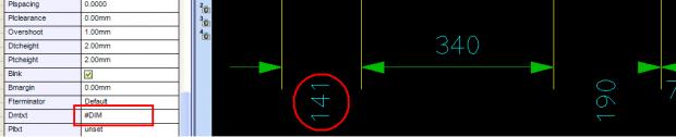

How to get calculated dimension value of #DIM
Mark Anthony Jumao-as

it is stored in EXDMTXT pseudo attribute
var !dimValue exdmtxt
q var !dimValue

Hi RUAV,
WAAAAAHHHHH! So great.
:fat: i took a sneak peek to pseudo att but it slip through my naked eyes.
Now, i can work with it. Nyahahaha...:highly_amused:
Thanks a lot.
AJ
