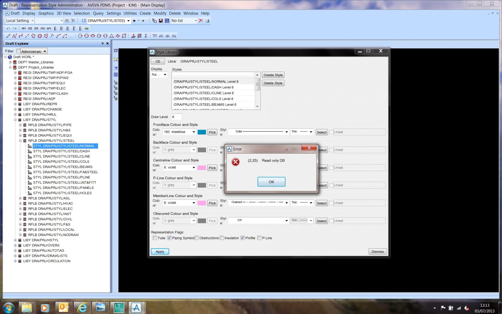

Read only Error when modifying Style Libraries in Draft

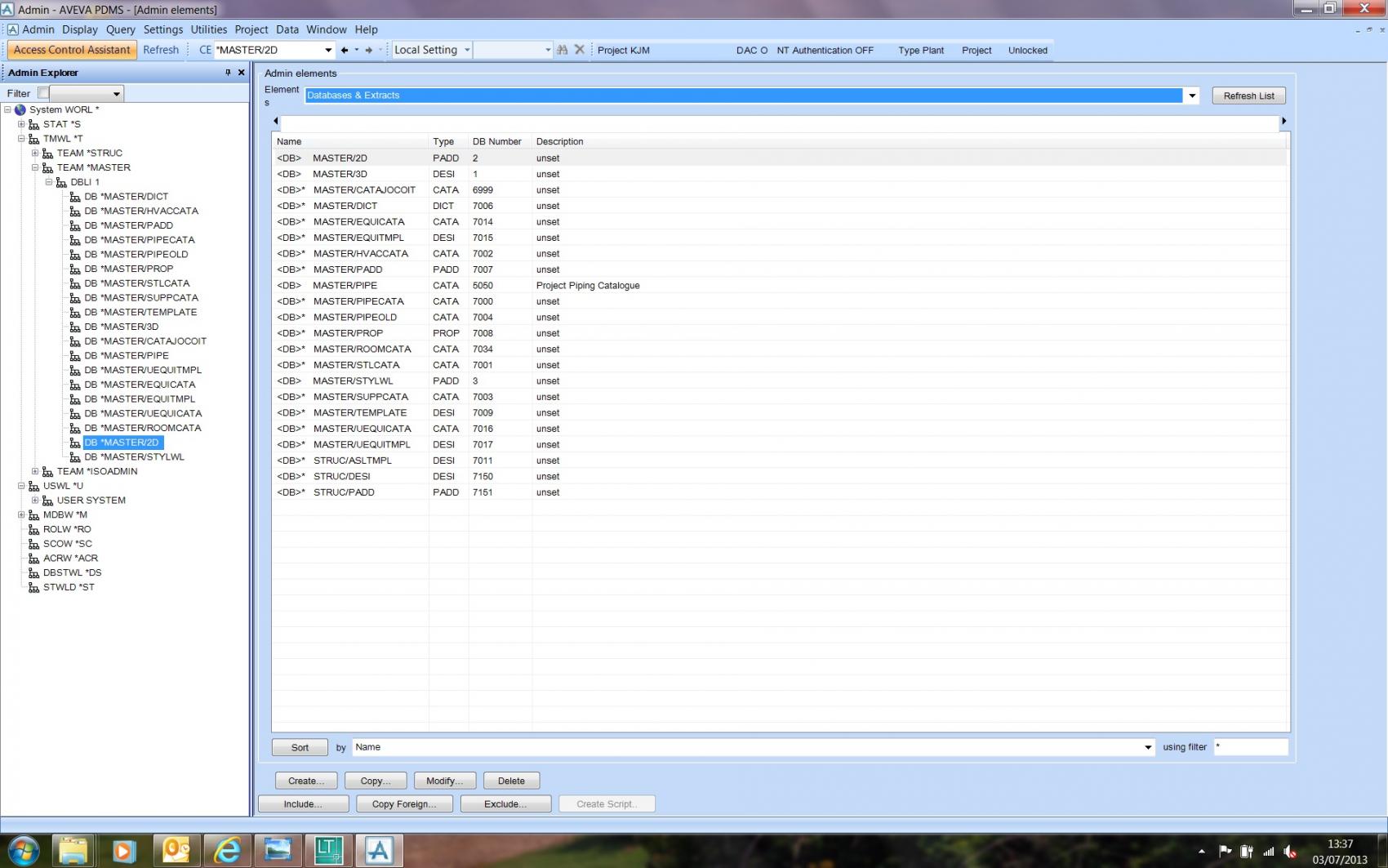

have you entered with free user ,and have you created draft db for your project
Admin
over 12 years ago
please check that the mentioned db is allocated to which team and the user your using is member of that team.
e.g. master/2d is allocated to team DRAFT
and your user is ABCD so the ABCD should be member of team DRAFT

If you are using standard Aveva styles they are located in DB MASTER/PADD Number 7007.
In your project, that is a foreign db. So you do not have write access to it...
James
over 12 years ago
Sorry for the late reply.
Thank you for your responses. I think I will create my own style if this db cannot be modified.
