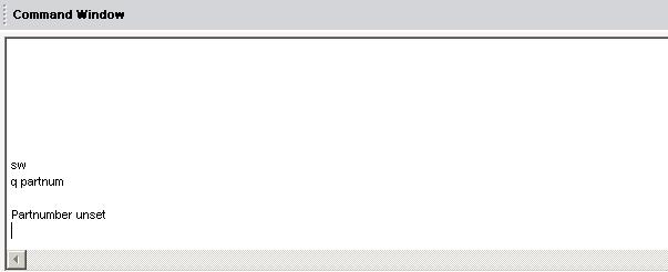

I've created partnumber for pipe components in spooler module, and it can be query in design and spooler module.
e.g. partnumber 68
But it can not be query in draft module, only show me: partnumber unset
Could some one can help me?

in draft if you type command
sw
you can access to design members from there you can try.Anyway draft data is taking from design only.

So if you set attributes in Spooler you have to "connect" Spooler with Draft. Do it in Admin module, or ask your admin to do it. Then you will be able to see the spooler data. Design data you must already be able to see in Draft.

Make sure the ISOD database used in SPOOLER is included on your draft MDB.

Thanks for your help. I am the admin of my team.... but I never set this, how to to "connect" Spooler with Draft?

In Admin module:
Project > Module Definitions > then button - Advanced Settings
