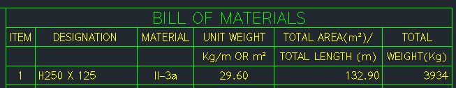

In my code I have take
Pos - position (index)
Beam Type = as a Name of Catref
Length - as a Cutl
Weigh - as a weight
I am facing a problem to make BOM that will be show in backing sheet, MY lead wanted it automatic run thru macro or PML in PDMS draft. I have done with it thru running report in pdms design and bring it manually in PDMS draft. But he didn't want it.
If you have any macro or PML for it, could you please share it to me?
Appreciates for your reply.

I have done lots of this kind of macro but in each case the header of bom and principle of calculation and filtering are different. So if you want me to help please send me email and describe mentioned point (header, do you need total quantity or just pos by pos in a row, attributes with information for each column)
It is not enough. Please read carefully what i have wrote. I suppose you also want add panels there as far as there Area so it means there more conditions so until i get full description i can't help. And just do not bother this thread please use email
