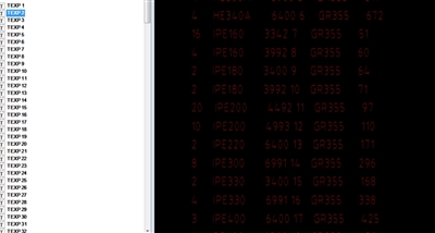

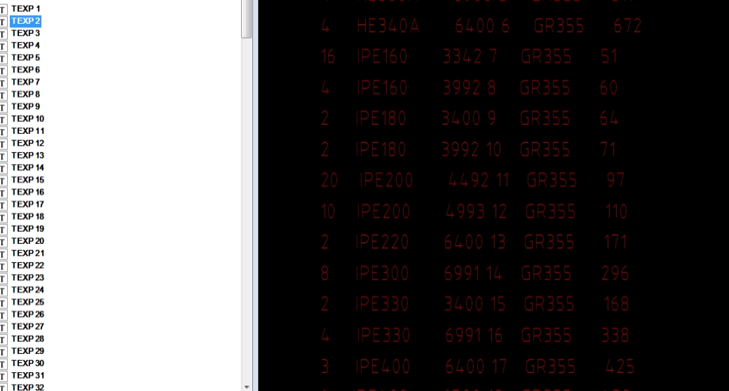

    As far as I know, if you are using PDMS fonts, you should define in Admin a Uniform Width font type if you want to align those columns....
    Try with this: http://52.178.132.139/showthread.php?t=10908

    i already tested and it's working with proportional TTF.But TTF makes me problem for DXF export and specific stuff ( layers conversion) in ACAD.. That's why i would like to keep the normal Font.. Thanks for your reply.
