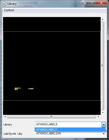

    If I am not wrong, it depends on the way the libraries are sorted in the Draft Hierarchy....
    If you read DRAFT Administrator Application User Guide.pdf - Chapter 2.4 Searching Libraries - it says:
    When a DRAFT application user attempts to create a new element, for example, a symbolic
    label, the application searches for relevant Libraries in a specific sequence. It looks at each
    LIBY in the DEPT in the listed order until it finds one that contains appropriate type of
    Library. It then adds this LIBY and all subsequent LIBYs to the scrollable list on the Library
    form until it finds a LIBY which does not contain a relevant LALB. No further searching is
    carried out.

    You need to change the Symbolic Labels field in User Defaults so it points to an alternative LIBY (any you want)
    Settings > Users Defaults...
    Navigate to the LIBY you want to use, then hit the 'CE' next to 'Symbolic Labels' - It the second one in the list.
    Then hit 'OK' to close the form.
    Re-open the Create Symbolic Labels

    cheers corrado that worked out for me :)
