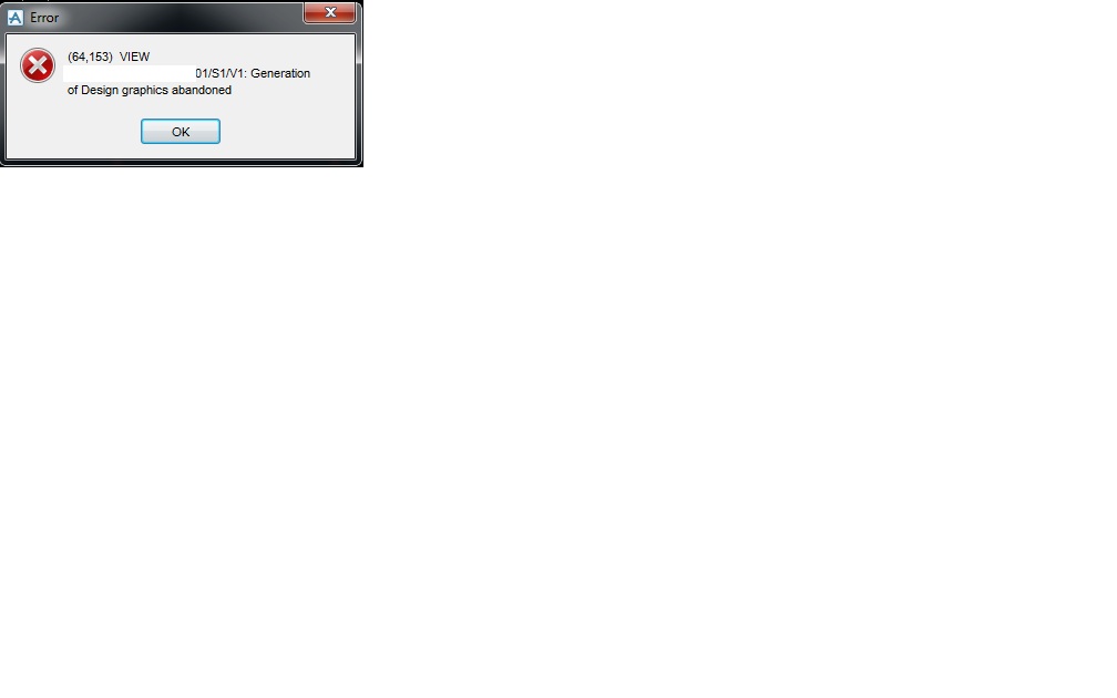

View cannot update design.. error come out ??

the graphic gone from the view.. only dimension and note label left..

some local rules created under view creating the problem.
try to define correctly the local rule or delete it if you don't need.
after this it will work.

Hi Deva,
Thanks for great answer.. its working fine now!!
