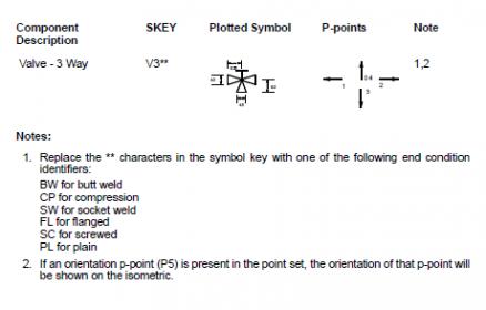

    Hi
    Can any one stear me in the right direction.
    I would like to create an SKEY which has one inlet and to outlets.
    So a simple rectangle with arrive at the bottom and two leaves at the top, so that the continuation is shown correctly on the iso.
    There doesnt seen to be a good base SKEY to use.
    Thanks

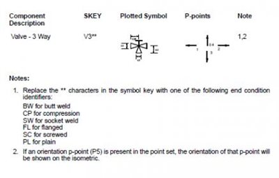

    Hi
    Thanks for the reply, What I am actually looking for is a block type symbol where p1 arrives at the bottom and p2 leaves at the top with another p point leaving in the same direction as p2, so not the same setup as a valve.
    Thanks again
