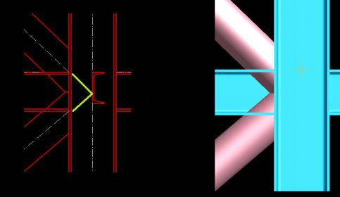

[FONT=Tms Rmn]Suggested tested solutions, but not ideal:
1. In Design:
Set-up the Posline of all Sjoi in NA and create Tmpl + Negatives for have the Posstart or Posend of bracings at the working point.
2. Or in Draft:
Modify the style for show the hidden-lines (all in Off except Profile, FFstyle, BFstyle and MLnstyle).
The good thing is that it is showing the centerline, but it is showing as well the hidden-lines that I don't want show and in the same style.
3. Or in Draft:
Have 2 views rather than one.
One showing all except centerlines (all in Off except Profile, FFstyle, BFstyle),
and the 2nd one showing only the centerlines (all in Off except MLnstyle).
This system would show exactly what I want, but it is 2 times the number of views.
If you think about better solutions please give it.
[/FONT]
you may add a SCTN (without any spref) each end of the brace to the NA of cloumn in Design. In Draft, use a local rule to control how the SCTN is represented. That is only my idea and have not tired it. Do let me know if that works.
Try setting the DUNION on the frameworks to 2. We just came across this problem. If you have the SCTNs in different frameworks this should be your solution.
