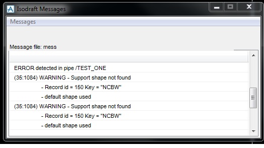

I tried many ways...setting SKEY as ATTA and Base key as FLOR..but still the shape which i drawn is not coming in isometric

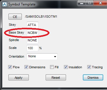

See..In Paragon...the gtype is ATTA...in SDTE,I didnt get SKEY for Attachment..so I write skey as ATTA only....
In Draft...for Iso Symbol Template, I have set SKEY as ATTA and Base KEY as FLOOR..Spindle NONE..Scale 100 %, Orientation as NONE...

Dont give SKEY as ATTA, may be its conflicting, because Gtype and Skey becomes similar.....

then wat should I give?
pranjal
over 11 years ago
you can give anything....try SPAT (as a short form of support atta, see it it works
sanjyot
over 11 years ago
And what about base key?
