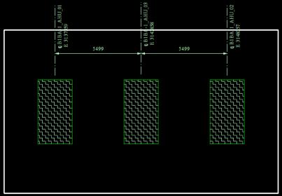

• Create new line (dash or chained type)
    Then create new hatch with two patterns using your newly created line.
    One pattern is horizontally and one is vertically.
    Sorry if I can't explain it to you one by one.
    If you want I can give you the macro through DBListing.
  • [COLOR=#222222][FONT=Times New Roman][FONT=arial]Create new line (dash or chained type)
    If you want I can give you the macro through DBListing.[/FONT][/FONT][/COLOR]
  • [QUOTE=MarvinGonda1988;85601][ATTACH=CONFIG]7435[/ATTACH]
    Here, the pattern you want can be done.
    You created a new hatch pattern for this? If Yes please highlight the procedure. This will be very much helpful for me.
    Thanks in advance.
