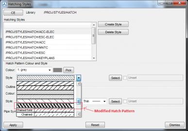

    Thanks for the reply, but I am still not able to create new hatch pattern. Please guide me in detail.

    Hi Power,
    try this:
    NEW STYLWL   -- Create a style world
    NEW FSTYTB   -- Create a fill style element
    NEW FILLST     -- Create a fill style
    NEW HPATTE   -- Create a Hatch pattern
    P.S: Refer point '8.4.2 And 8.4.3' in Draft USER GUIDE for implementing the new style.

    The icons you see at %pmllib%\icons\styles are only images representing the macro of each hatch patterns.
    So when you edit the image through Paint, you have just edit the image but not the macro.
    I never try create my own hatch, you may give a try creating your own.
    Try read and understand the procedure on this manual:
    C:\AVEVA\Plant\PDMS12.0.SP6\Manuals\Docs\DRAFT User Guide.pdf Chapter 8.4.2 User-Defined Fill Styles

    [COLOR=#222222][FONT=Times New Roman]OK,.. Give me some detail like length of vertical and horizontal bars,..[/FONT][/COLOR]

    I'll just assume that height and length of lines is 6mm. If you want for specific dimension just let me know.

    Yes MarvinGonda, This pattern and dimensions are completely fine. Please let me know how you did this.
