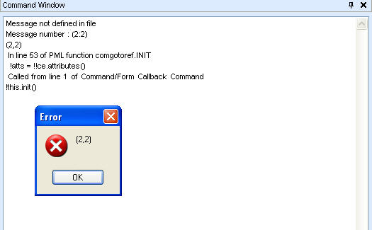

Please help me this error (2,2)!!!

No...It works on sheet also...

There is some limitations of User defined attributes on an element. if this exceeds then the error may prompt. You may try to remove the unwanted UDAs of the project from the SHEET level.
