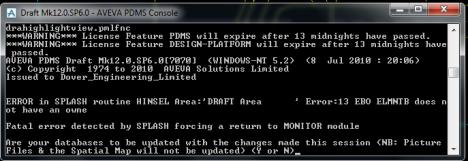

Draft Module FATAL error DRAFT

FATAL error DRAFT

    Try using Utilities-->Clean Up Annotations... first.
  • Venkata Rao Peta
    Try to update picture on a sheet which is creating Problem
  • PRASHANT PRAKASH UPARKAR
    PRASHANT PRAKASH UPARKAR over 11 years ago
    Yes picture file can cause this problem
    Stay on the sheet
    q picf command will give you the path of the picture file
    rename the picture file to .corrupt and update the drawing again and do savework
    and then check
  • Naresh Tarani
    Naresh Tarani over 11 years ago
    Hi Guys,
    After trying above options also, still it is giving fatal error...
    Database Integrity Checker from Admin Module
