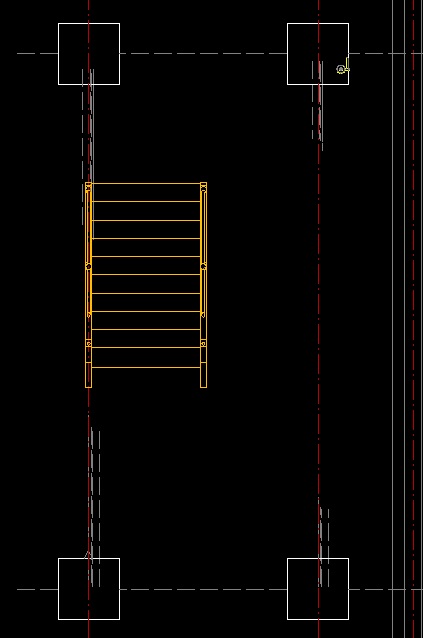

Draft view issues

    FIrst check what rrsf have been set on view...
    then go on that particular rrsf there you must have defiined rrule for pipie,stru,civil,hvac...etc
    for each rrsf there will be criteria and styf...
    there you will get under which criteria and styf (you will need to play in that) your ladder falls and also might find why sctions are coming in breaks...
  • Venkata Rao Peta
    You Should Define Representation Rules.

    [QUOTE=pmlsan;86867]Hi all,
    I have two queries in a draft view attached here.
    first one is section are not coming continuous..they are coming in breaks..
    second one is if i want to change the color of the ladder..how to do this ???
    Hi,
    Your ladder break is because of Z value range in the limit.. it need to go down or up to certain level to make it fully seen.

    Thanx for the reply Han_BFY...All issues have been resolved now...Actually in Representation settings was not proper thats why issues were there...it solved now.... :)
