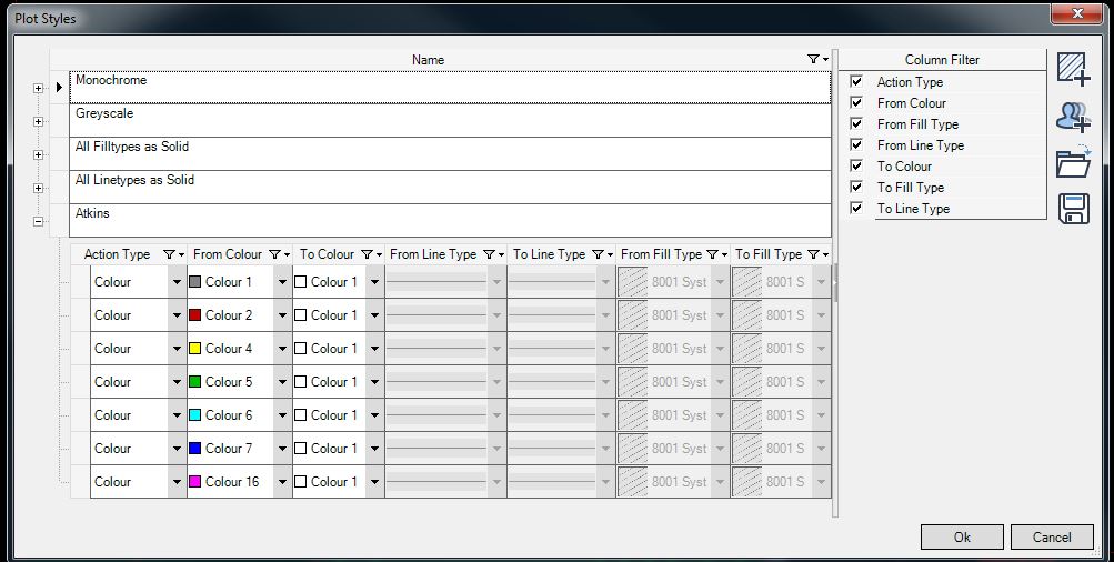

i cant seem to work out where some of the default settings in E3D e.g. plot styles and print settings are stored.
for example i have created a custom plot style and i want it to be available to use every time you run E3D without having to import it and i want everyone in the office to use the same plot style.

I probably got what you mean...
You can save your user defined styles in a .mac file.
This will go by default in C:\Users\Public\Documents\AVEVA\Plant\E3D\Data1.1.0\USERDATA
You can distribute it/them all over.
Then you can re-load it from the same form.
Hope this make sense...
