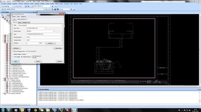

draft module problem
AJ
AJ over 11 years ago
  • Admin
    Admin over 11 years ago
    You should use styles and rules
  • AJ

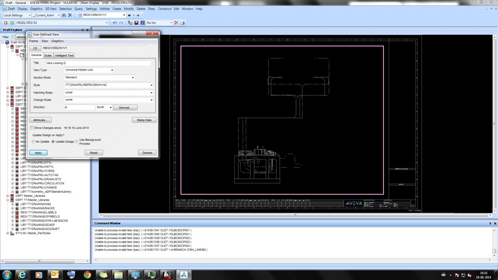

  • Venkata Rao Peta
    Ur Draft Administrator Should Create Representation Rules For the Draft.
  • Admin
    select something else in Style drop-down list
    for example something with GEN/BASIC and update your drawings

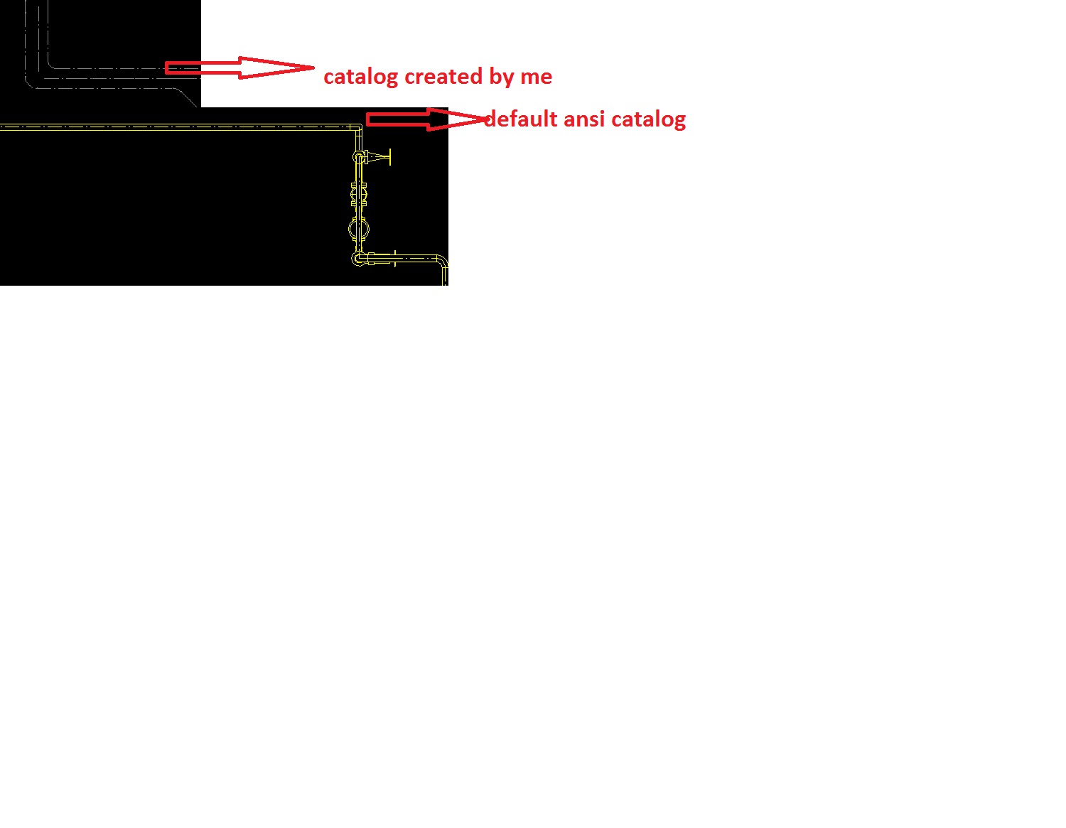

    oh I see.....I got this problem because I din go in sample user.
    can give any doc for update this. are can any other feature to copy those rules from sample project
  • Venkata Rao Peta
    q rrsf
    this command on view level take you to representation rules.
    Certain rules you have to set for ur projects.

    ya I tried this before it din come...now It came.....thanks.....
